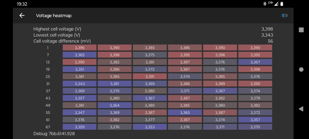

At 0% you are far far away from 2,5V. My observation some 3 days ago: with "turtle" light, at some 5%, I couldn't get full power - it was limited to full minus 3 bars on indicator. Voltages at full throttle were as below. It was refreshing slowly and values are just +/- . My experiment was made to check cells voltage differences at approx. 0% - are they discharging evenly or not. For me - not bad
Voltages at some 5% SOC and max throttle

2,5 Volt ist aber die tiefste Spannung eines LFP Akkus.
NMC liegt höher.
